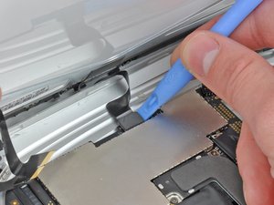

Use a plastic opening tool to remove the ambient light sensor connector from its socket by gently prying upward.
