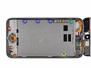

Remove the following eight Phillips #00 screws:
One 3.5 mm Phillips screw
Two 3.0 mm Phillips screws
One 2.3 mm Phillips screw
One 2.4 mm Phillips screw
Three 2.0 mm Phillips screws
