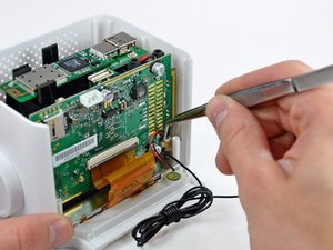

Use a pair of tweezers to pull the microphone connector away from the front of the chumby.
Use a plastic opening tool to pry up the ZIF lock on the display ribbon cable socket.
Pull the display ribbon cable out of its socket.
