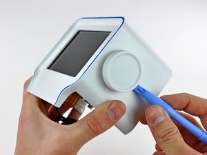

The volume knob is simply pressed onto the splined volume control shaft.
Use a plastic opening tool to pry evenly around the edge of the volume knob until you can remove it from the chumby.
Volume control commands are sent via a rotary encoder that translates angular degrees of rotation into binary code recognized by the board.
