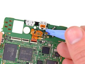

What's that? I can't hear you—speak up. Oh, you're the ear piece, I see. Well, I'm sorry, you're going to have to come out too.
No leopard print on this ribbon cable, but that's ok. It's just the main speaker.
For those itching to reveal their love of Britney Spears new album or Justin Beiber's new hit solo, fret not, this tiny litte speaker packs enough power to resonate [tinny, muddled] music throughout the room.
