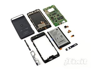

Motorola Droid RAZR Repairability Score: 4 out of 10 (10 is easiest to repair).
Once the battery and motherboard are within reach, replacement is easy—no soldering required.
The "non-serviceable" back was a bit of a pain to remove.
The front panel is adhered to the AMOLED display, so they must be replaced as one expensive unit.
All plastic frames and casing proved to be incredibly tedious to remove, and felt like they would break at any moment.
There are copious amounts of adhesive holding the phone together.
