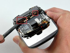

Two connectors need to be disconnected in order to remove the black PCB.
The PCB is glued to the rest of the Pre. A gentle pry with the spudger separates the two.
