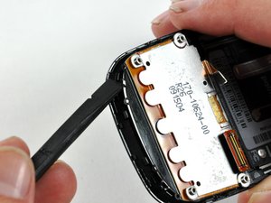

Removing the keyboard bezel.
The hardware keyboard and its associated sliding mechanism weighs 32 grams. That's nearly 25% of the weight of the phone! Even if you're not a fan of a hardware keyboard, there's no denying that packing the keyboard into a device that's not much larger or heavier than the iPhone is a very impressive engineering feat.
