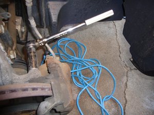

After jacking up the car PLACE JACK STAND(S) under the car for safety, THEN take off the wheel.
Take a 13/16" socket and breaker bar to remove the lower caliper bolt. A large amount of force may be required.
Take the 13/16" socket and remove the upper caliper bolt. A large amount of force may be required.
When reassembling the torque for these bolts is 126 ft lb.
Be ready when the two bolts are backed out enough, as the caliper will be free to fall. The bolts don't have to come out all the way for the caliper to be free.
You MUST not allow the caliper to hang by the brake line. Have a milk crate and wood ready to hold it up.
