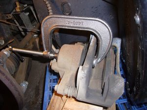

The new pads are thicker than the old, so the piston will have to be pushed back. Leave the old pad in place for now since the piston is hollow. Use the C-clamp or a disc caliper tool to gently push the piston back. Go slow and steady - you are forcing brake fluid back up to the reservoir and it needs time to equalize the pressure.
