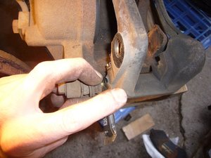

If the carrier can't move freely back and forth, uneven pad wear can result. The pads should come with a tiny tube of high temperature grease. Carefully ease back the boots from the slides, and grease both rails. There's 2 for each side of the car, so budget accordingly.
