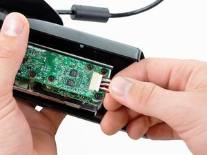

All four microphones connect to the motherboard with a single cable connector.
After removing three connectors and seven T10 Torx screws, the top board can be separated from the other two boards.
