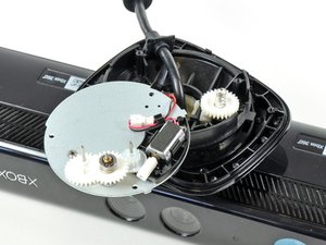

The Kinect's motor and gears don't appear too robust.
About the size of an American quarter, the base has a tiny motor with three fragile plastic gears. Barring overheating issues with the top unit, we're guessing this motor assembly will be the Kinect's weak point.
Do not physically force the Kinect into a specific position—allow it to automatically calibrate its aim.
