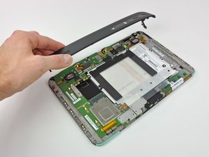

After disconnecting the volume button ribbon cable and removing two screws, the top portion of the upper case lifts off.
This case component houses the power button, LED diffuser, camera port, and speaker grills.
The two-piece rear case design is a unique choice by Motorola, and makes accessibility and replacement of the inner components much more feasible.
While the larger lower portion is made of aluminum, the upper part is made of plastic.
