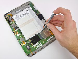

The battery is held in by ten T6 Torx screws, with yet another two T5 Torx screws just to hold down the unique battery connector. This, of course, poses no problem to our 54-piece bit driver kit.
The 3250 mAh, 24.1 watt-hour lithium ion polymer battery boasts a healthy 10 hours of Wi-Fi browsing and video playback, and a massive 3.3 days of MP3 playback.
