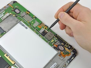

The 5MP rear-facing camera doesn't appear to be anything special, but certainly nice enough to record some HD videos.
With the 2MP front-facing camera, you can chat over Google Talk with Video Chat to anyone with a Gmail account.
Unlike Motorola's other recent device, the Atrix, both cameras are connected to the motherboard by separate cables. You won't have to replace a ton of other stuff should just your camera fail.
