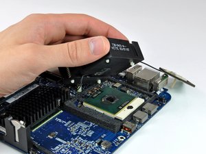

The heat sink is still attached to the logic board by the thermal sensor cables.
Lift the heat sink off the processor and lay it on the AirPort card.
