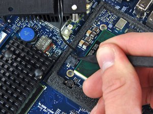

Use the tip of a spudger to push the heat sink thermal sensor connector out of its socket.
It may be necessary to work from alternating sides to 'walk' the connector out of its socket.
Remove the heat sink and set it aside.
