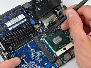

Lay the heat sink on the AirPort card and use a spudger to reconnect the heat sink thermal sensor.
