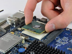

Mac mini Model A1176 CPU Replacement

Grab the processor by its edges and lift it straight up off its socket.
Rotating the processor while lifting it out has the potential to break pins off inside the socket. Lift it straight up.
