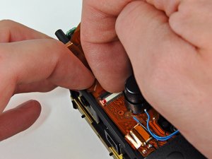

Use your fingernail to flip up the ZIF retaining flap.
Make sure you are prying up on the ZIF retaining flap, not the socket itself.
Pull the ribbon cable straight out of its socket.
