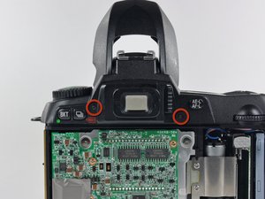

Remove the two 7.3 mm Phillips screws securing the top case to the D70 near the eyepiece.
