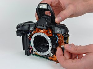

Carefully lift the top cover near the mode dial as you pull the mode dial ribbon cable away from the lens base.
Remove the top cover from the D70, minding any cables that may get caught.
