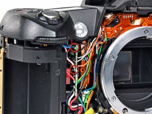

Touch the bare leads of a capacitor discharge tool to the pink and blue capacitor leads soldered to the circuit board near the AF lamp.
At this point, the capacitor should be discharged. Avoid touching the bare leads to prevent a shock if the capacitor is still partially charged.
