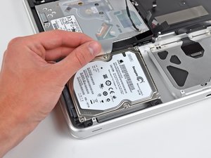

Using its attached pull tab, lift the hard drive out of the upper case.
Don't try to completely remove it yet, as it is still connected to the hard drive cable.
