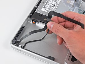

Carefully peel the IR sensor cable off the adhesive securing it to the upper case.
Pull the hard drive bracket/IR sensor housing away from the side of the upper case.
Remove the hard drive/IR sensor cable from the upper case.
