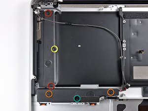

Remove the following six screws securing the subwoofer and right speaker to the upper case:
Two 3.2 mm Phillips screws.
Two 12.3 mm Phillips screws.
One 2.5 mm Phillips screw.
One 8.3 mm Phillips screw.
Remove the subwoofer/right speaker from the upper case.
