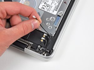

De-route the three antenna cables from their channels in the AirPort/Bluetooth housing.
De-route the camera cable from its channel in the AirPort/Bluetooth housing.
