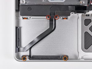

Remove the following four screws securing the hard drive/IR sensor cable to the upper case:
Two 2.5 mm Phillips screws.
Two 10 mm Phillips screws.
